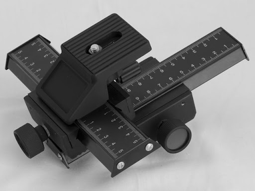

Yes, the higher the aperture number the larger the dof at that distance. You will probably have to use a tripod for the longer exposure times or a ring flash to give you better lighting. I have also found a focussing rail beneficial for making small adjustments.

A focusing rail?

Its essentially a rail that the camera slides backwards and forwards upon, when attached to a tripod. It can be moved in very small incriments, thereby moving the focal plane fractionally further back each time you take a shot.
The resulting images are then put into some "stacking" software, which combines all the images, rendering the finished picture in focus and sharp throughout, like the fine example Cutter posted
Some move backwards and forwards. Some can also move left to right too for ease of positioning.

Looks exactly like one of my hubby's DIY tools! I don't have photoshop so multi pics are no good form me yet. Hoping Santa brings photoshop. I have so much to learn, oh dear! My photo's really are rubbish...lol
